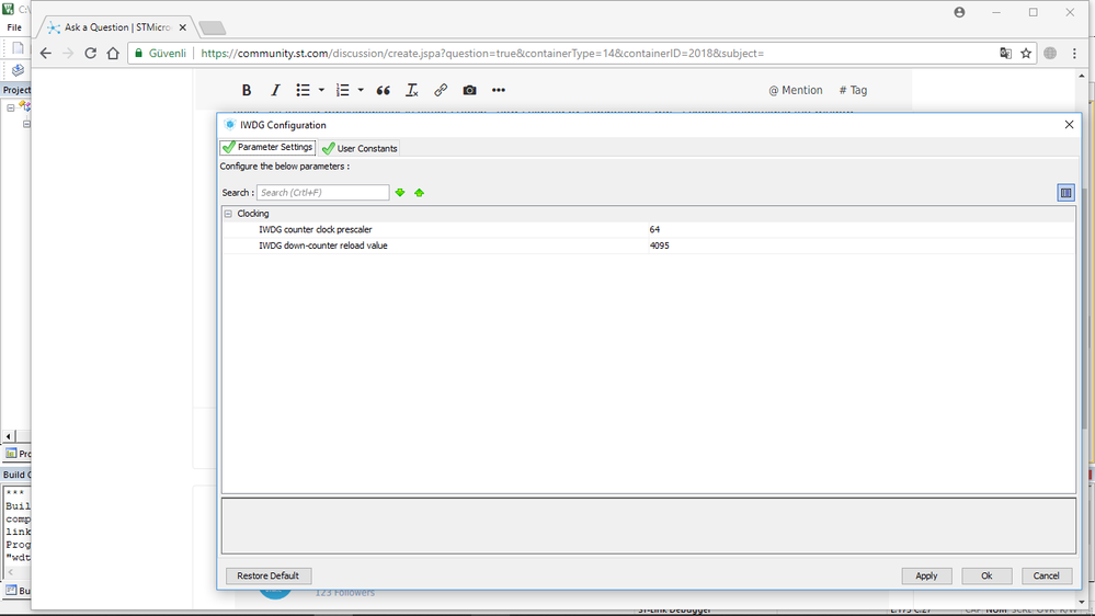

hello , im testing watchdogtimer in stm32f103cb , now i started by independant wdt i suceed ,

i coudlnt understand the window one , any way my question is :
in cube mx we control the timout of the wdt by
if i select 64 as prescaler according to the datasheet it means my timout is 6553,6 ms for example
so what is the meaning of 4095 the downcounter ? what is the downcounter role ??
thanks for ansewering

The prescaler 64 is used as a divider of the WDG clock. The countdown timer is the number of tick clock until the WDG resets.
