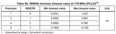

Here are the maximum timeout values for WWDG given in the datasheet. In general, much shorter durations than IWDG. Adjust for your PCLK.
Watchdog cannot be disabled once started. You need to reset the chip to disable, or continue to reset the watchdog in the bootloader.
