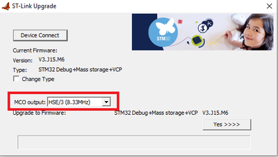

Watch what value HSE_VALUE is using, against the MCO frequency the ST-LINK/V3 is actually generating.
25 MHz / 3 = 8.333333 MHz, not 8.000 MHz
The firmware update tool should provide some clocking options.

2024-08-27 9:00 AM
Could you please share your ioc file? What clock source you set? HSE or HSI?
If you are using HSE in Bypass mode you need to check the Clock source frequency generated by the ST-LINK over MCO.
Could you please check this information using ST-Link Upgrade tool and see what MCO output is set?
By default it's set to HSE/3 = 8.33MHz.
