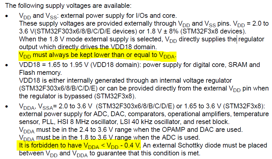

The reference manual lists some rules for this scheme. Probably other info in there as well.

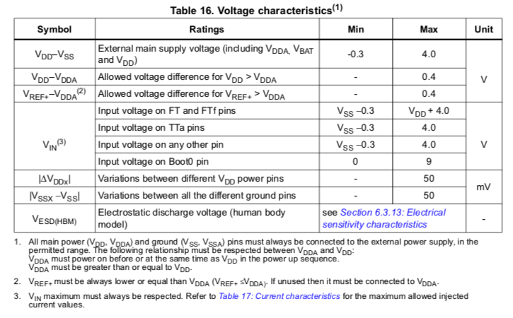

Seems Vdd can go higher than Vdda in terms of maximum ratings. It's the impact on accuracy I'd have to find out.

which manual is this?
I can't find that first condition in mine.

As the datasheet states you should definitely avoid higher voltages at VDD compared to VDDA, while 400mV is the maximum difference.
It depends on your settings and hardware, if the resulting measurement showing some difference.
