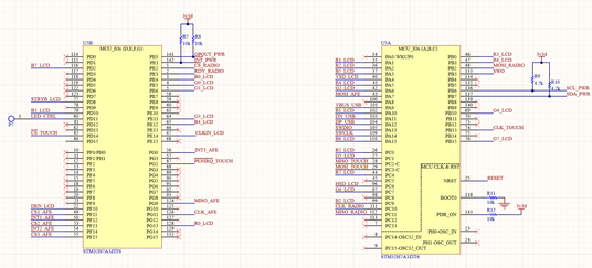

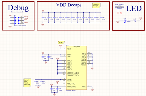

MCU schematic:
Power Section of MCUPower Section of MCU
Signals of MCUSignals of MCU
The schematic symbol was manually created with the nucleo hardware files as reference.

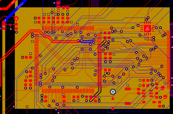

MCU PCB:
PCB routing for MCUPCB routing for MCUThe yellow plane is a 3v3 digital power pour. USB is the differential signal coming from the top left of the MCU. Most of the signals are going to the LCD connector to the right. I have placed capacitors on pins as follows:
PinLabelCapacitor
6VBATNone, connected to 3v3d
30VDD_54.7uF
32 & 33VDDA & VREFPTied together. 100nF and 1uF
39, 52, 62, 72, 84, 108, 144VDD_7, VDD_9, VDD_11, VDD_16, VDD_2, VDD_13Separate. 100nF
71, 106VCAP1 & VCAP2Tied together. 2.2uF near each pin.
95VDD33_USB_1100nF and 1uF
131VDD_26100nF in parallel with 100nF
It is unclear to me exactly which of these are necessary. For example why pin 131 needs parallel 100nF capacitors as in the nucleo hardware.

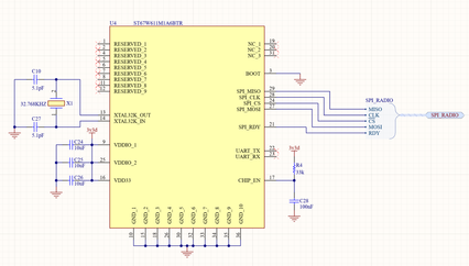

Wireless schematic:
Wireless SoC SchematicWireless SoC Schematic

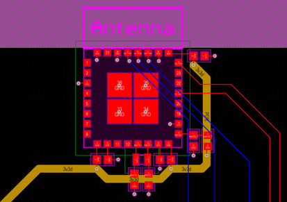

Wireless PCB:
Wireless SoC PCB routingWireless SoC PCB routingST67W611M is placed on the top edge of the board such that the antenna is unobstructed. A ground pour is on layer 2 (not shown in images) underneath the entire board.

Hello @AuFries and welcome to the community;
I recommend you referring to Getting started with STM32H7A3/7B3 line and STM32H7B0 Value line microcontroller hardware development to check your PCB. This application note is intended for system designers developing applications based on STM32H7A3/7B3 line and STM32H7B0 Value line microcontrollers,  and provides an implementation overview of the following hardware features:
• Power supply
• Package selection
• Clock management
• Reset control
• Boot mode settings
• Debug management
Also, the Evaluation board (STM32H7B3I-EVAL) and Discovery kit (STM32H7B3I-DK) are proven designs and must be used as foundations for specific application development.
I hope this help you.
Thank you.
