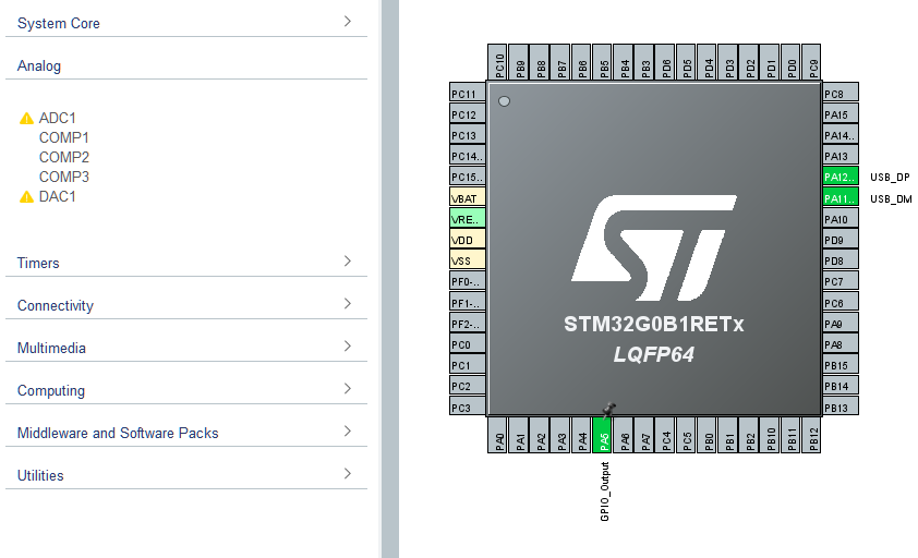

It is my understanding that STM32G0x1 devices do have VREFBUF, however I don't see the option to configure the VREFBUF in the Analog section.

Found it! The GUI VREFBUF settings for this device the setting is under System Core SYS -> VREFBUF Mode
