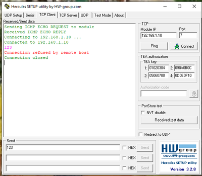

After done all this process it successfully debugs and make the connection successfully

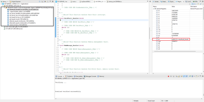

The connection made successfully, whenever I try to send the data, the following error
occurred. The below attachment shows the error.
