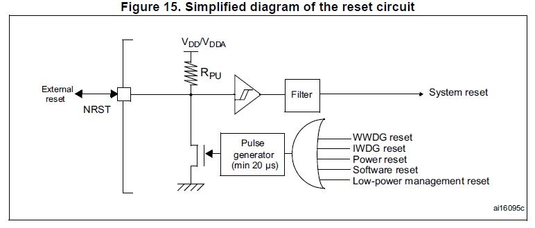

What time constraint? I said I liked 100ms. The STM32F4 POR has a minimum ~20us pulse width. I think that's a bit tight for sloppy external RC reset circuits, or supplies with ridiculous rise times between 1.2 and 2.7 V.
I suspect the 300mV comes from the fact there will be some internal conduction paths. Things aren't supposed to be powered that way, but might find a path, whether it's through internal or external parts.I'm not sure you're going to get ST engineers with familiarity of the silicon at this level answering on the forum.2015-07-20 10:52 AM
