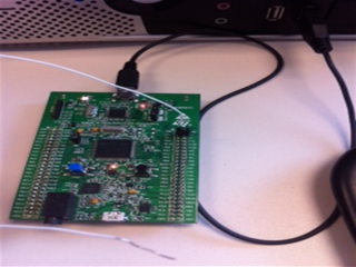

I'm connecting stm32f4-disco through USB to the computer and I'm measuring the 5v output pin from the board with a scope and I get 3,9 V. Did I burn it or something? Thank you2015-07-20 3:55 AM

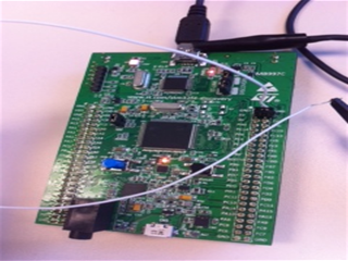

I'm trying to do this:

Thank you for reply.
The usb cable is short, like in the picture. I think that the diode in serie with USB is D1. I get 5V on one side of the diode and 3,9V on the other side. I think this should be something like 5V and 4,7V.2015-07-20 10:50 AM
