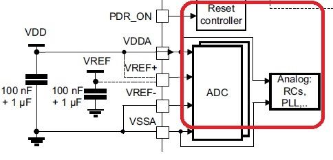

is written: ...During the startup phase VDDA must arrive first and be greater than or equal to VDD.
... Why that what if it is not so? Is it possible to start first VDD before VDDA? If yes, under which conditions?2015-07-20 5:55 AM

Sorry, AN4080, Page 6:
... The VDDA voltage level must always be greater than or equal to the VDD voltage level and must be provided first. ... What about startup/power on in this case? To the previous questions, one more: Now after the knowledge from AN4080. What will happen if VDDA fall down and VDD is OK.2015-07-20 8:43 AM
That same page 6 lists the functionality that will be lost. Don't know if anything will be damaged. ST's guidance is to use the same source for Vdd and Vdda, and add additional filtering to Vdda to reduce ADC and DAC conversion noise. If you are doing something different, I suspect you may be on your own. Cheers, Hal2015-07-20 9:11 AM

That is my question. I have an LDO on VDDA. Theoretically it can: start later than VDD can fall down anytime2015-07-20 9:21 AM
Going to cause the VCO/PLL/HSE/HSI to FAIL, or become unstable, and if it gets sufficient low the processor will be held in reset.
I don't expect gray smoke, but you will get undesirable operation...2015-07-20 9:27 AM
