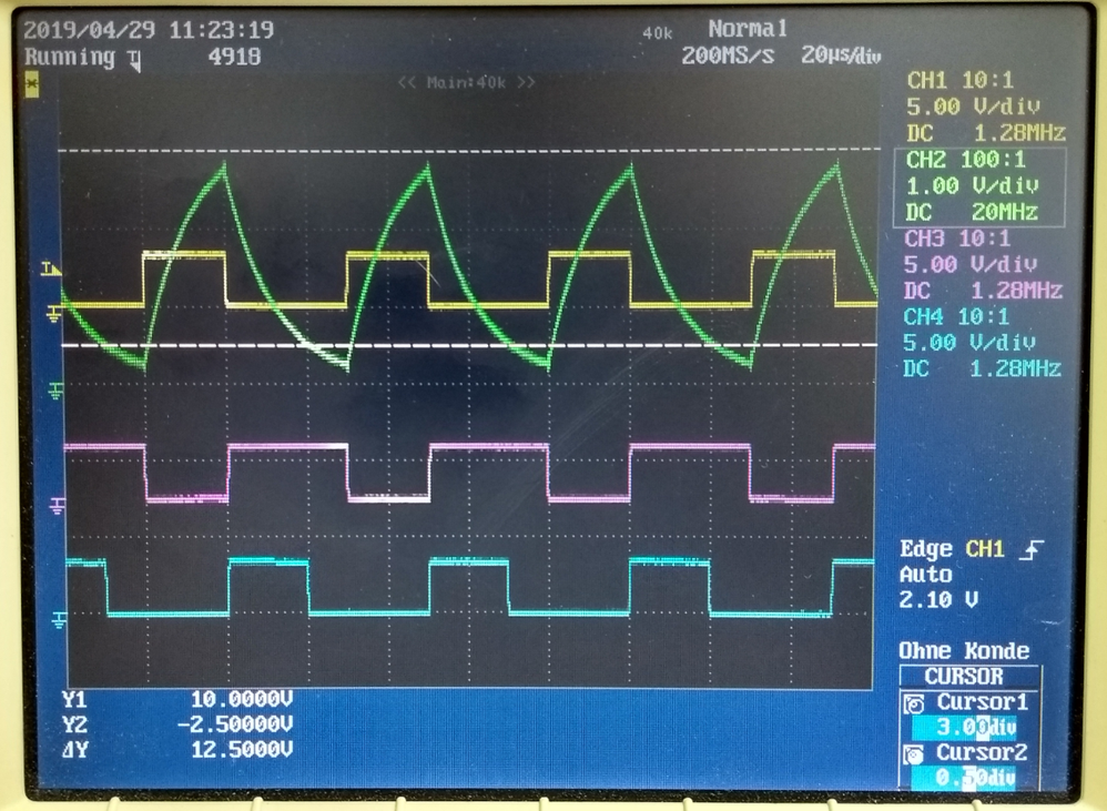

Here are my probed signals:
The yellow signal is the high side PWM
The green signal is the load voltage
The purple signal is the low side complementary PWM
The cyan signal is the COMP2 output, which is blanked with the same period of the duty cycle and go low as soon the signal crosses the minimum threshold (white line crossing the green)
What I need is to find a way of "ANDing" the complementary output (purple) with the COMP2 output (cyan) in software, anyone else had this need? is there any other way of doing it with the timer peripheral?
