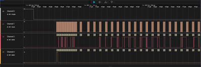

I am using the SPI on the STM32H743ZITx as a SPI Master in Full-duplex mode to transfer large data packets (1600 bytes). But instead of seeing the data being transferred in a constant burst, I see it being sent out a byte at a time with gaps in between, apart from a burst at the start of the SPI transaction.

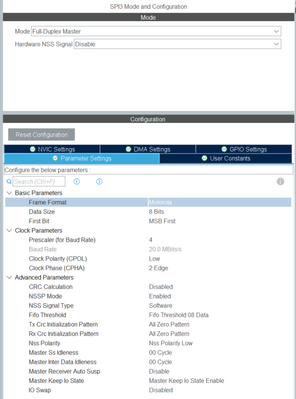

Here is my SPI3 settings in STM32CubeIDE, v1.16.1:
The SPI initialization is the default MX_SPI3_Init() provided by Core/Src/spi.c in STM32CubeIDE.

}This is what I see on the logic analyzer:
I expect the SPI CLK signal to be continuous during the transfer, instead of a byte-by-byte transfer with gaps in between.
What can I do to push up the performance of the SPI transaction?
