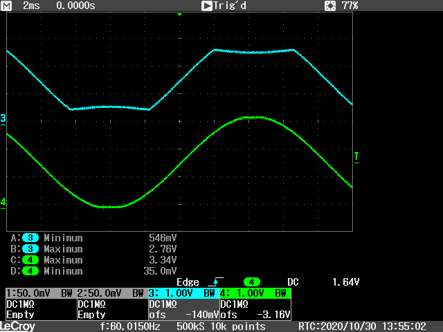

Hello everyone,
I am using the STM32F413 Nucleo-144 development board to generate 2 sinusoidal wave forms at 60Hz. To do this, I have DAC_OUT1 (PA4) and DAC_OUT2 (PA5) conversions running through DMA. The signal from PA5 appears as expected when I measure on the oscilloscope (approximately 3mV ~ 3.3V), however this is not the case with the signal from PA4. The top and bottom of PA4 signal gets clipped as seen in the following image:
The top signal is generated by PA4, the bottom signal is generated by PA5.
I cannot see any reason for this being the case as the same values are being converted for both signals, and I do not see any datasheet difference between the 2 DACs. if anyone can suggest any reason why this might be the case, it would be greatly appreciated!
Thanks

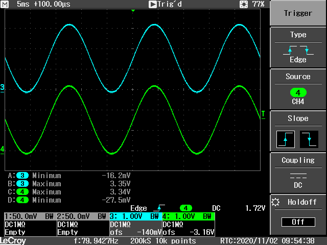

By switching the output buffers to disabled, I was able to generate the following waveforms. This is the results require, thank you! Can you explain why this works? I am not sure I understand the output buffers correctly
2020-10-30 10:57 AM
Different settings of DACs (buffer on/off)? Show registers.
Different loading on the board? Review board schematics.

2020-11-01 1:28 AM
Weird... the signal from PA4 is not only clipped, but appears to be more linear than a sine wave - more like a triangle wave being clipped. Is triangle wave output somehow being enabled?

2020-11-02 5:26 AM
2020-11-02 6:47 AM
Not quite.
Search this forum for "DAC inverted" output. The reason is physical damage to the buffer. Your symptoms are somewhat different, but similar in that the suspicious output is related to buffer being switched on, and I suspect damage is the underlying reason here, too.
