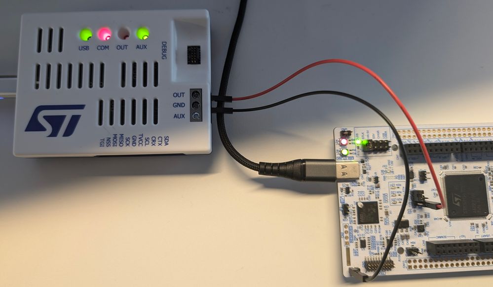

Hardware (Nucleo144 STM32H563, STLINK-V3PWR):

HAL_PWR_EnterSTOPMode(PWR_LOWPOWERREGULATOR_ON, PWR_STOPENTRY_WFE);The current is 3600µA (3,6mA).

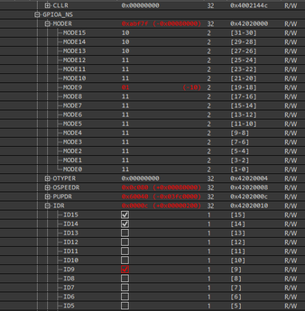

using reverse engineering I found the solution. I simply found out what function call is the problem, it was "USBPD_CAD_Init(..)". Then I scanned all HW registers that are changed.
So I found this:
It seems that a port pin changes its function. After turned the pin back to input mode, the current is as before.
Here my test code:
