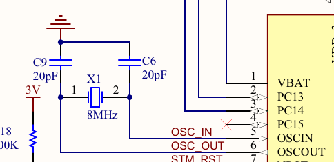

your osc circuit should look like this:
show your circuit, if you expect any useful help.

Show your circuit as constructed.
