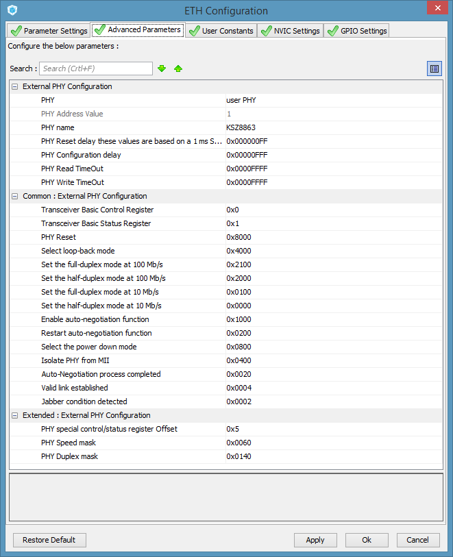

I'm interfacing a KSZ8863 (Micrel, 3 Port Switch with 2 PHY and 3 MAC) over MII from a STM32F207ZG. I've used the STM32CubeMX to generate the code with the LwIP Stack and FreeRTOS.
So far, I've successfully communicated over SMI to read/write some registers (just debugging, if the bit-banging is working) and I've done some network stuff (Ping/TCP frame send) through port 1 and 2 (ping and tcp sent from computer on port 1 to a device on port 2).
But I'm not able to communicate correctly over the MII interface and send or receive ethernet packages. I think it has something to do with the Ethernet and LwIP configuration in the STM32CubeMX tool, specifically the register addresses. Here is my configuration so far:
I am absolutly not sure, wich settings I have to change (I couldn't find some parameter documentation about those STM32CubeMX settings).
I've changed:
My application is running in the following steps (main):
Does anybody know how to configure those ethernet settings correctly? Or am I completely on the wrong way for interfacing the KSZ8863?

Im using the same ICs and stuck in configuration.
Can you help if you have figured it out?

I've got a KSZ8081 on my project and I can't even get it to ping (I'm in MII mode). Do you have any example projects that at least ping?
How did you configure the PHY if DP83843 is the only PHY available and the custom PHY does not fit with the datasheet?
