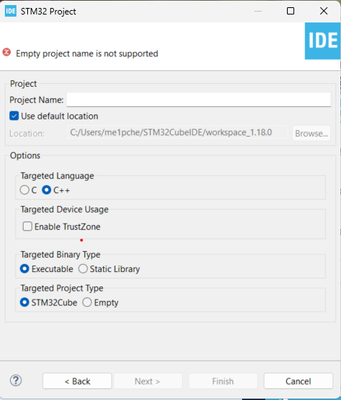

I try to create a C++ project for Nucleo-u575ZI-Q using STM32CubeIDE but seems only C files are generated. I always choose C++ in Targeted Language, like the image shown below, when starting a new project.
I just wonder if there is something missing.

CubeMX only generates C files. Setting the project type to C++ will allow you to add *.cpp files and have them be compiled, but it does not change the files that CubeMX generates. This is the intended behavior and there's no way to change it.
