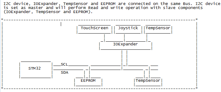

2012-10-31 6:21 AM
I have found some links which point to the newer libraries from ST: [DEAD LINK /public/STe2ecommunities/mcu/Lists/cortex_mx_stm32/Flat.aspx?RootFolder=/public/STe2ecommunities/mcu/Lists/cortex_mx_stm32/AN2824 STM32F10xxx I%C2%B2C optimized examples&FolderCTID=0x01200200770978C69A1141439FE559EB459D7580009C4E14902C3CDE46A77F0FFD06506F5B¤tviews=130]click here
It says thatApplication Note AN2824
is OLD. Newer I2C libraries are located here: There is also an example when three I2C devices connected to same I2C of STM32 as below.We’re moving the ST Community to a new platform to give you a better and more reliable community experience.
