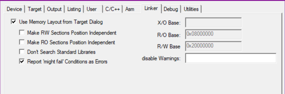

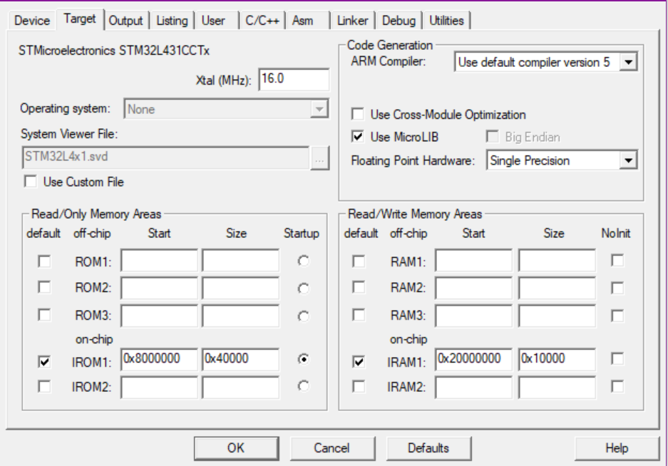

Thanks for the explanation! If that is the case, if I were to reduce the available FLASH for compiler in my case, would it be enough if I just leave the IROM1 'Start' to 0x0800_0000 and modify the IROM1 'Size' to 0x0003_F800 in Keil's Target Dialog configuration:
and leaving 'Use Memory Layout from Target Dialog' option checked under Linker Settings?
Or would it still be better to just modify the scatter file immediately after unchecking the option above?
2020-12-02 4:56 PM
I'm not very familiar with uVision, but it looks like it is the right and sufficient thing to do in this case.
