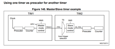

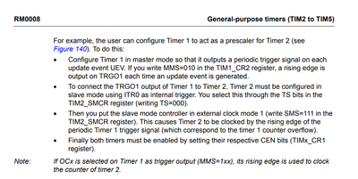

I want to use Using one timer as prescaler for another timer mode (see figures below).
I want the slave timer to increment its counter every time the master timer generates update events. But the slave timer does this regardless of the update event (incrementing occurs constantly). I can't understand why. Tell me what I did wrong? I'm attaching the code.
