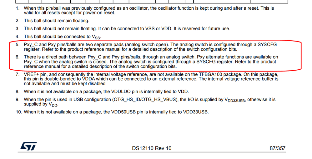

https://www.st.com/resource/en/datasheet/stm32h743xi.pdf#page=87

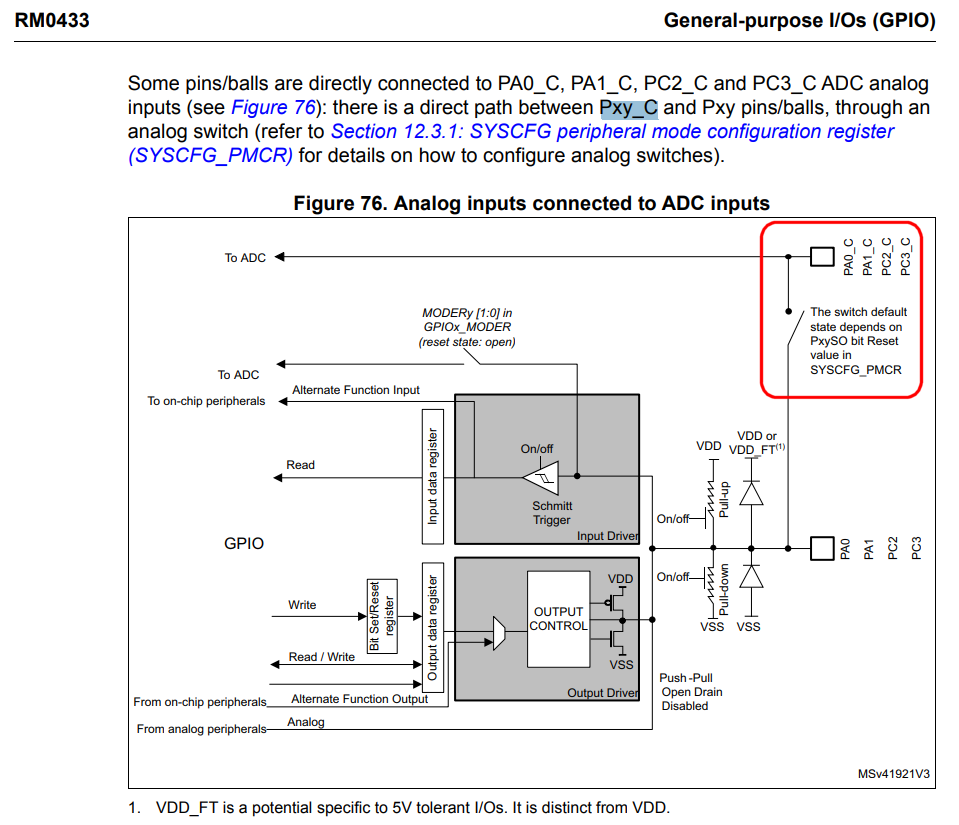

I understand that it is done by configuring the corresponding bit in the SYSCFG->PMCR register. However, I don't see CubeMX modifying any value in that register when generating the code (which is probably why it doesn’t work).
On the other hand, I don’t understand how PA0_C can function as a GPIO output, but when I configure it for PWM, it doesn’t work. I don’t see how that could be related to the configuration—either both modes should work or neither, which leaves me in the same situation as before.
So, it’s either a CubeMX bug (yet another one) or I’m missing something here.

Similar topic here:
https://community.st.com/t5/stm32-mcus-products/stm32h743vg-pin-pc2-c-and-pc3-c/m-p/787756
Which links to this article: FAQ: Default State of STM32H7 switches connecting Pxy_C and Pxy pads.

According to the article, and with that package, all different pads PXC_C are exposed on the package and all the switches are off after reset leaving a given PXY_C disconnected from PXY pad.
@AAlis.23 wrote:
the pin type for PA0_C is listed as ANA (analog input only). However, I can configure it as an output and successfully generate a square wave by toggling it in a loop.
Telling that you can toggle PA0_C pin without configuring the switch is something strange because after reset PA0_C is connected only to the ADC input (the switch is Off after reset).
You need to check the bit PA0SO value in SYSCFG_PMCR. Is is set to 1?
Knowing that:
0: Analog switch closed (pads are connected through the analog switch)
1: Analog switch open (2 separated pads)

This is expected as the PA0_C switch is OFF.
