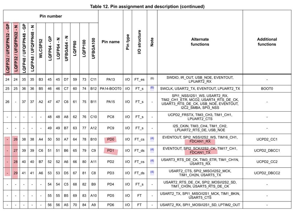

@EniRot99 wrote:Given that these specific pins (PD0 and PD1) are not available on my microcontroller, I am curious to know:
Are you sure about this? The DS indicates there are two 32-pin variants, and one of them does have PD0/PD1.

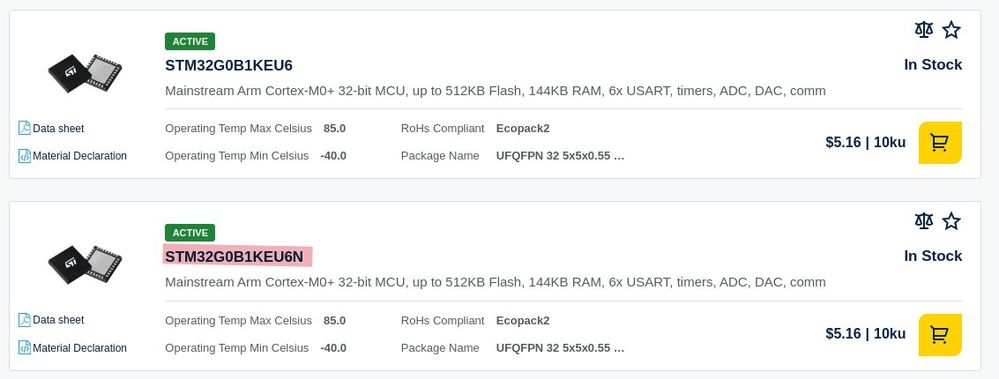

And from the ST direct store:

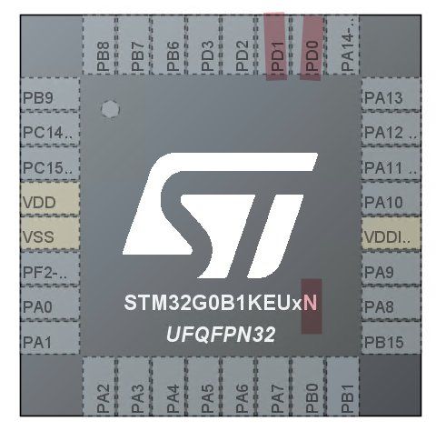

and from CubeMX:
