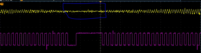

Problem: I am working with a instrument where we frequently get the problem of frequency drop out, i.e. suddenly frequency signal goes missing i.e. goes to zero, this cause the loss in data as shown in the below image. Yellow is received frequency signal from Photodetector and Purple is the demodulated data (our desire output). When frequency goes zero the purple line is constant so data is lost.

As a visualization: Look at picture
Yellow (F_A) will be continuously monitored, Purple (F_B) should be store in buffer zone. As can be seen rectangular point yellow goes zero and purple become constant, so this constant purple gap should be filled by buffer zone.

How do you get the digital signal from the analog signal?
It looks to me, you use a digital input, e.g. with a Schmitt Trigger.
This works fine until the analog signal amplitude drops below a threshold. Therefore, you get this "strange" constant digital signal (the Schmitt-Trigger will not trigger or flips into other state without a chance to come back, hysteresis is too small).
You could add an external amplifier to increase the values during this period where you do not have a signal (it is too small for your input, Schmitt Trigger).
BTW: why does your signal drops below a threshold?
You could also try to sample this signal as real analog, with an ADC. Now you might see that the amplitude of your signal goes below a minimum threshold. Potentially, you can see still a waveform with low amplitudes (but based on your scope picture it looks to me more like "there is not a signal anymore, just noise").
Before starting with some SW work arounds - check your external signal:
I think, you get in a region for your sensor cannot provide anymore correct (reliable) data. There is not any solution in SW or HW (just to change to a different sensor with other characteristics).
