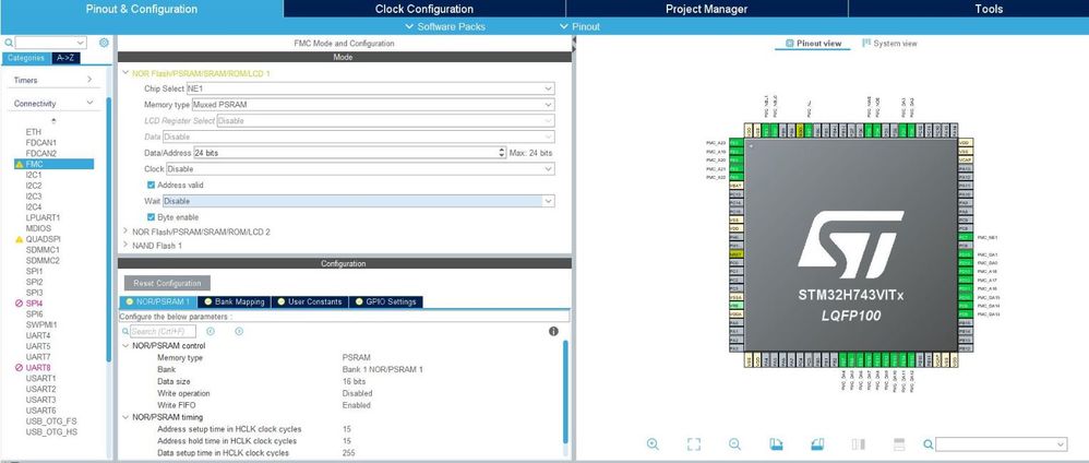

Hello @prsh ,
You can use external RAM: FMC-SDRAM, as mentioned in the AN5188, in the Table 4. Peripherals required by memory type.
Check with CubeMx configuration:
You have these application notes that provide more details regarding external memory:

Sure, the FMC peripheral will interface with external memories such as SDRAM.
The STM32H743I-EVAL board as onboard SDRAM. You could use those schematics to see how it's wired, or use CubeMX.
