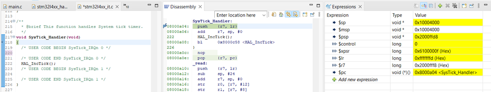

On SysTick interrupt handler entry:

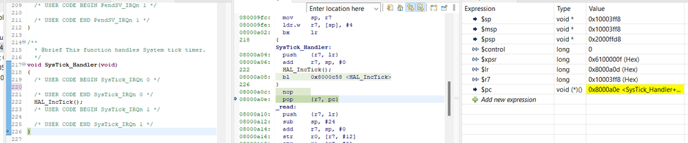

On SysTick interrupt handler exit(`pop {r7,pc}` causes hardfault):

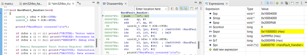

On Hard Fault exception entry:
