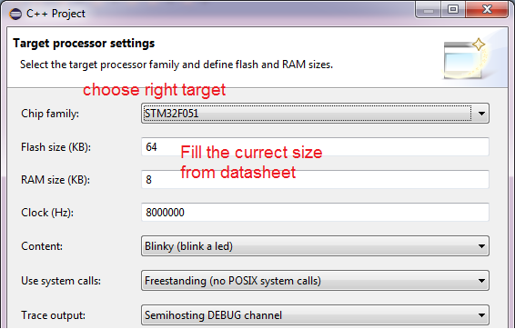

1. When you create new project make sure you entered right data.
2. Check your link files (*.ld).

That's a good point. I actually created a blank C project. I used the .S and .ld files from the templates folder provided by STM. I am looking to how to specify the .S file but I think Eclipse did compile the .S file in the project but I have to make sure. I am trying to see where in the project that the .S file is explicitly specified.
As for the Flash size and RAM size, I believe they are defined in the .ld file.
As for Instruction set, should I specified Thumb (-mthumb) or ARM (-marm)? Currently specified as Thumb.
Endianess : Toolchain default or Little endian or Big endian?
Unaligned access: Enable, disable, or toolchain default?
