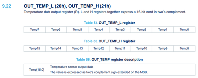

2023-07-05 6:00 AM
When reading from your temperature data registers, note that the first register (0x20) is your least significant byte and the second (0x21) is most significant. Your code above is shifting the LSB 8 bits whereas you should be shifting your MSB 8 bits. Therefore, when your register data changes by 1 bit, your readings are changing by 1<<8 bits.
When converting this to degrees C, 1<<8 bits changes the temperature by massive values.
Also, this is unrelated, but I don't see the need to store the data into a uint16 only to reassign it to a new int16.
Just put the data into an int16. There is no such thing as a 2's complement conversion. It is 2's compliment which is automatically read out as human decimal.
I hope this helps.
Tom

I do understand your argument and I tried to make the necessary changes in my code. So the way I exctract my tempRaw now looks likes this:
tempRaw = (uint16_t)(regData[0]<<0 | regData[1]<<8);
However I am still getting values that do not really make any sense and are jumping all over. Any other recommendation that you could give me on what may be causing this or what should I look into?
