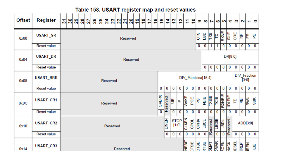

2019-03-17 2:23 AM
STM32L1XX doesn't have ICR Register on USART peripheral,
what's the similar register with STM32L4 XX ?
page 746, 27.6.8 STM32L1 Reference

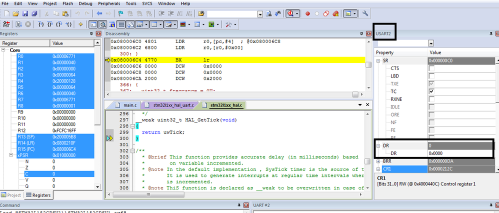

2019-03-20 12:16 AM
I don't understand there's nothing on USART_DR USART2 register,
but when I checked with PC there are many datas from GPS module,
Any wrong initialization ?
Thanks
