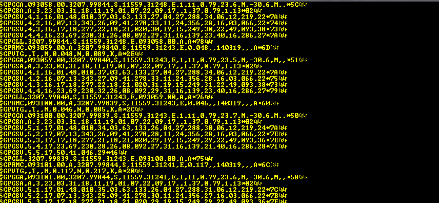

2019-03-14 2:35 AM
I got output from
serial to PC
May be with interrupt is better ?
