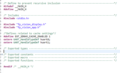

Use this in main.h
extern UART_HandleTypeDef huart8;
And this in main.c

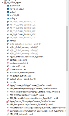

still have this trouble fp_vision_app.c:280:25: error: 'huart8' undeclared (first use in this function), should be fp_vision_app.h?

2023-08-21 11:03 AM
means Use this in main.h
"extern UART_HandleTypeDef huart8;"
And this in main.c
and in the fp_vision_app.c
include ''main.h" no ?
