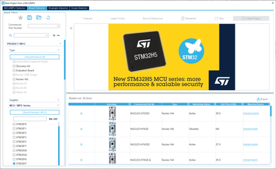

You can see all the ST boards available in CubeMX. Here are the first few for the STM32H7 family:
