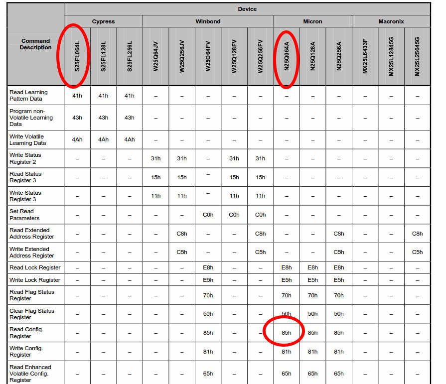

Thanks, the problem is that STM32446E-EVAL use a old N25Q128A13EF840E memory.
This old chip have a different command, for example 0x85
(#define READ_VOL_CFG_REG_CMD 0x85),
not present in the S25FL.
Than I don't know the correct command sequence for S25FL
The followd is a table command migration from
This is why I am looking a specific example for the S25FL family, even just the sequence of commands
Thanks
