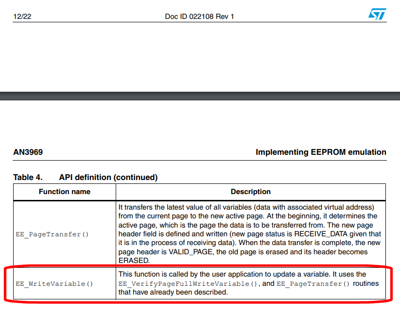

Did you study the Application Note, which describes what this code does, and how to use it?
As that description says, the EE_WriteVariable() function updates a Virtual Variable in the emulated EEPROM.
See also the documentation in the source code itself:
* @brief Writes/updates variable data in EEPROM.
* @param VirtAddress: Variable virtual address
* @param Data: 16 bit data to be written
* @retval Success or error status:
* - FLASH_COMPLETE: on success
* - PAGE_FULL: if valid page is full
* - NO_VALID_PAGE: if no valid page was found
* - Flash error code: on write Flash error
So that's writing 16-bit data - or two characters at once.

* @retval None
//char writeString[] = "Hello Hashmi";
char readString[64]={0};
int main(void)
HAL_Init();
/* Configure the system clock to 180 MHz */
SystemClock_Config();
/* Unlock the Flash Program Erase controller */
HAL_FLASH_Unlock();
/* Configure LED3 */
BSP_LED_Init(LED3);
/* EEPROM Init */
if( EE_Init() != EE_OK)
Error_Handler();
if (EE_ReadVariable(VirtAddVarTab[0], &VarDataTmp) != HAL_OK)
Error_Handler();
char writeString[] = "Hello";
for (int i = 0; i < sizeof(writeString); i++)
uint16_t charToWrite = (uint16_t)writeString[i];
// Pass the value, not the pointer
if (EE_WriteVariable(VirtAddVarTab[0] + i, charToWrite) != HAL_OK)
Error_Handler();
//printf("hello");

2024-11-25 2:53 AM
Again, please use </> button to share your code.
Thanks
