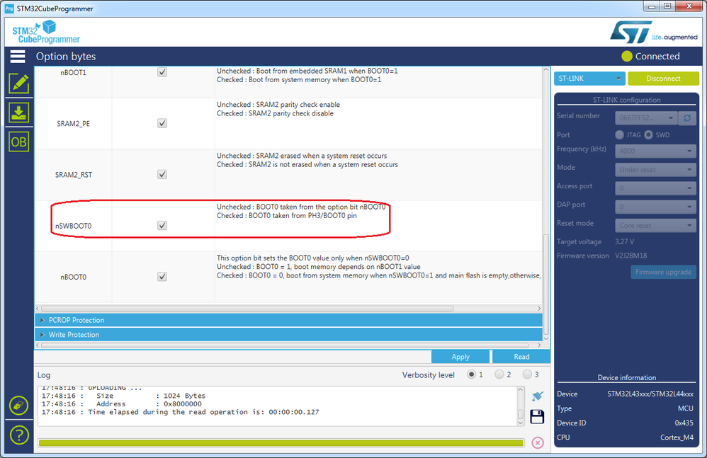

Oher solution is to use one of PC applications: ST-Link Utility or STM32Cube Programmer. Below I attach a picture, which shows Option Bytes with highlighted
nSWBOOT0.

Hello Maunik,
nSWBOOT0 bit belongs to so called Option Bytes region of memory. It can be modified in two ways.
One solution is accessing correct address in Flash memory. You can do it by using HAL functions. Inside Cube L4 package installed on your hard drive you can find an example how to access Option Bytes. Please refer to this path:
...\STM32Cube_FW_L4_V1.10.0\Projects\STM32L476G_EVAL\Examples\FLASH\FLASH_WriteProtection
nSWBOOT0.

2018-04-20 7:00 AM
Hello
Szymon,
You made my day.
I used the 2nd option (usingSTM32Cube Programmer
) and it just worked.Thank you very much for the easily understandable help.Though option one (programming the FLASH) is good for deep learners, it is quite lengthy and confusing for some one who doesn't know in detail about programming the FLASH.
