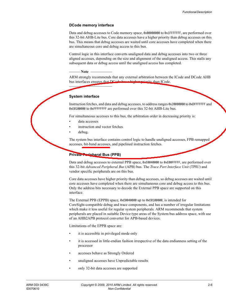

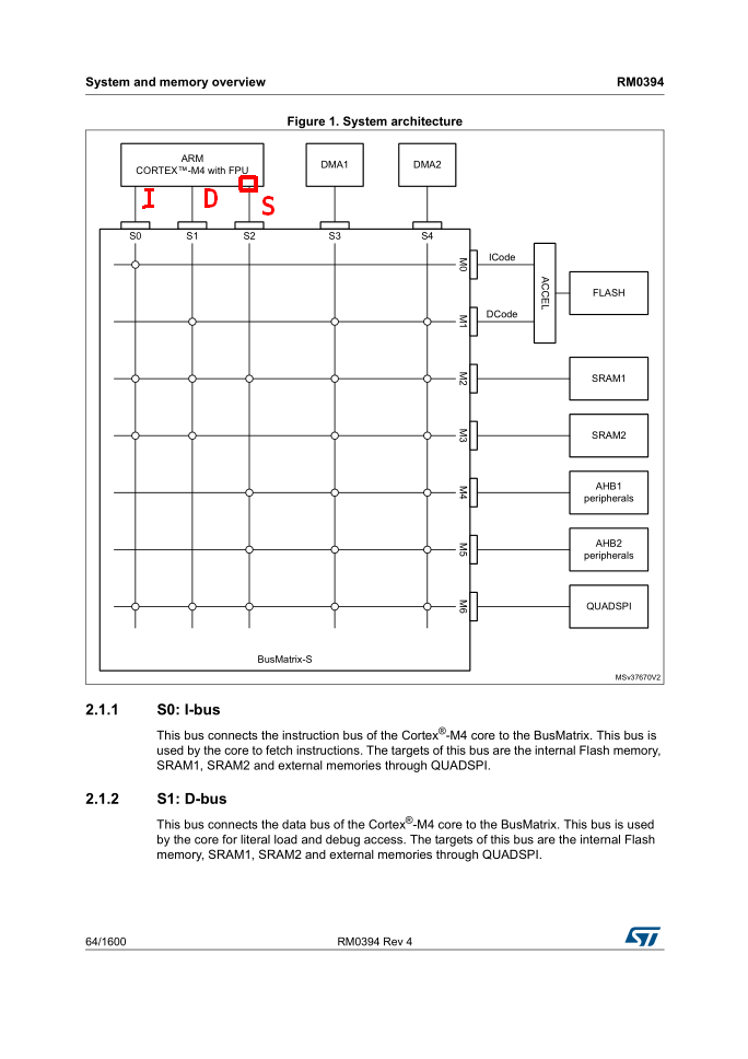

>> I didn't found a hint in the data sheets, that it isn't allowed to use 0x2200_0000 as source adress for the DMA.
> Bit-banding is a manifestation of the CPU core, not the memory buses outside of it.
This information is not that straightforwardly obvious, but it's there.
i.e. the translation between the "real" data on the bus system and the bit-band alias is performed here:
i.e. it's not in the path between DMA and any memory.
Some related writeup here.
