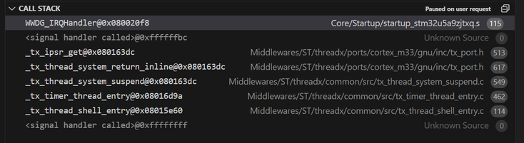

I am unable to make working ThreadX USBX Host example for STM32U5 adopted for Nucleo-U575ZI-Q.
All, but the last setup step described in Introduction to USBX section 3.3 complete properly, but when finally HAL_HCD_Start() is called, ThreadX crashes. What could be wrong/missing?
System crashes even before OTG_FS_IRQHandler() is called. HSI48 clock has correct frequency, I measured it.
