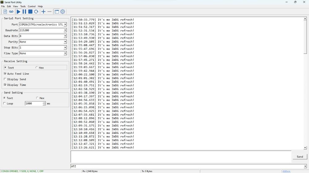

- I didn't refresh the watch dog timer anywhere. So, As per the program the system need to be reset in 32.768 seconds (approximately 33 secs). But in real case, the system got reset after the 39 seconds or in 40 secs. Why this delay of 7 - 8 seconds is taken for the system reset?

I have attached the output screenshot for your reference.

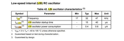

Well, you have not taken into account the tolerance of the LSI given in the data sheet of the STM32F446RET6. Unfortunately, no free-running oscillator with 0% tolerance has been developed yet, so the STM32F446RET6 has a tolerance of approx. ±47% given in section 6.3.10, table 42.
In your example you have determined a tolerance of (22s-18s)/18s = 22.2%, which is perfectly within the maximum tolerance.

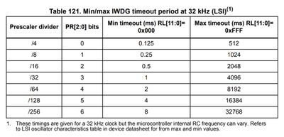

As you can see her:
Those values are for exactly 32khz LSI frequency .But looking to the datasheet we can find that the LSI frequency can be any value between 17KHz and 47KHz.
That means, the IWDG_time can change between ~22s and ~61s for Pre-scalar=256 and down counter reload=4095.
Best regards.
