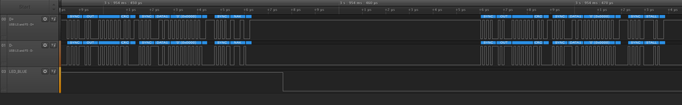

1) Failed USB transfer
LED_BLUE is toggled in USBD_LL_StallEP(...) of usbd_conf.c. After that, the PID OUT request from the host ist answered with a STALL handshake packet. Seems reasonable.

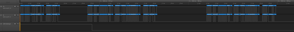

2) Successful USB transfer
In the reference project USBD_LL_StallEP(...) is called as well, but the PID OUT request is answered with NAK, not with STALL. Next, the host retransmits PID OUT, which is ACKed by the device and everything works fine. USBD_LL_ClearStallEP(...) is never called, so why does the communication not stall?

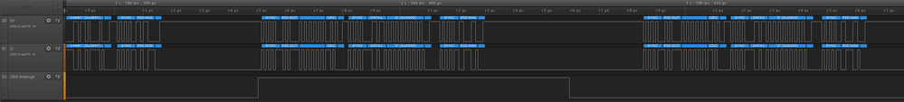

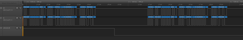

MCU is STM32L433CC. Meanwhile, I found the solution: I used an old version of the HAL library in my project, whereas the reference project had the latest HAL version. I didn't figure out the exact cause for this error, but in the old HAL lib the USB interrupt didn't fire after USBD_LL_StallEP(...). Maybe the stall configuration gets revoked by the interrupt. In the following screenshots, the third signal is toggled in the interrupt handler.
1) Failed USB-Transfer (old HAL version)
2) Successful USB transfer (latest HAL version)
