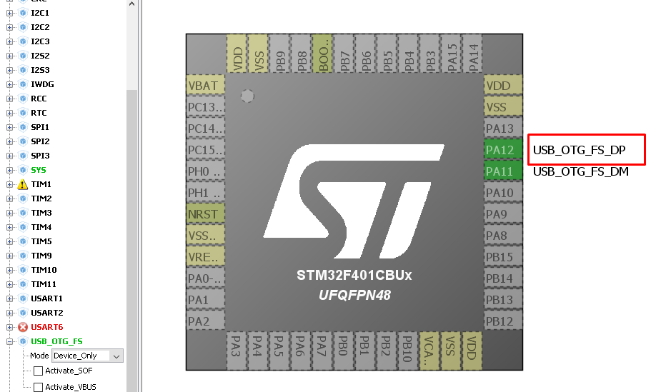

I use ''USB Device'' on STM.
My STM32F401 has USB OTG so it means that it can pull up USB_FS_DP data line without pull up resistor .
But I can't find a way how to do it, please help me

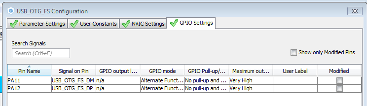

,By default, the USB selected pins will be configured as following (in USB_FS configuration wizard):
Select the pin for which the configuration hasto be updated (if this is really needed) then make the modifications you want.

2017-02-06 1:42 AM
Hi.
I've already tried this way, he didn't give any results.2017-10-04 4:36 AM
