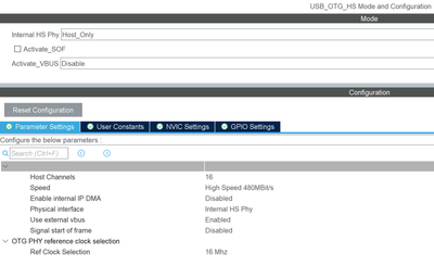

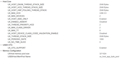

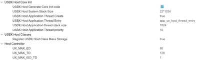

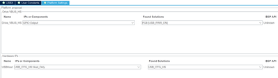

So far so good, so I activated USB_OTG_HS and USBX. I have it configured as follows:
I start the application. The host thread is created and started. All initialization passes without errors. The USB stick is powered. The `ux_host_event_callback` function is correctly registered. Yet, when I connect or disconnect the USB stick nothing happens. It's not detected. It seems like the USB interrupt is not triggered.

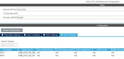

I tried to manually poll the PA11 and PA12 pin states (using MCU and SWD debugging). PA11 is low, while PA12 gets high when the USB stick is connected. So electrically it seems OK.
I enabled USB_OTG_HS global interrupt. It didn't help.
