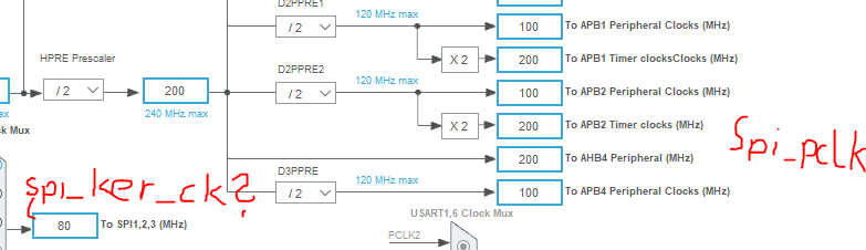

I am currently trying to get my Nucleo STM32H743ZI2 to send data via SPI to a different chip.
Im using CubeMX to generate a lot of the setup code as I´m pretty new to this chip. For the same reason, I use the HAL.
The basic configuration is:
My main loop just tries to send out data repeatedly
status = HAL_SPI_Transmit(&hspi1, &buffer, 8, 1);
HAL_Delay(1);If I set my prescaler to, lets say 8, I can see the data being transmitted with my logic analyzer without a problem. I can also see the EOT bit getting set in the SPI2S_SR register.
If I set my prescaler any higher though problems occur. I can still see the transmissions on my logic analyzer. The timing is much worse though.
After some investigating, I found the function
SPI_WaitOnFlagUntilTimeout(hspi, SPI_FLAG_EOT, RESET, tickstart, Timeout)in stm32h7xx_hal_spi.c which is the culprit. The library tries to busy wait for the EOT flag to get set which does no longer happen when i choose any prescaler >=8.
If I use the Interrupt or DMA mode to get around the busy waiting, I can only transmit once. Afterwards the functions returns HAL_BUSY. I think this supports that the EOT bit is not getting set.

2021-06-16 2:35 PM
Try using a 1000ms timeout. The 1ms min timeout value could be messing with the logic.
Monitor the return value and do something useful about it when it's not HAL_OK to reduce debugging time.

2024-07-28 10:30 PM
Came across this post while debugging something very similar today. In my case, I found out that the EOT bit wasn't getting flipped because SCK wasn't toggling, and SCK wasn't toggling because the GPIO "Maximum output speed" on the SPI pins was still set to "Low" and needed to be changed to "Very High".
It'd be a nice feature if STMCubeMX would cross-check the SPI clocks - it already has this in the Baud Rate field - and make sure the GPIO output speeds are configured to match.
