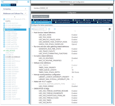

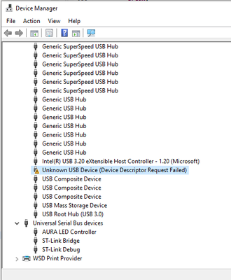

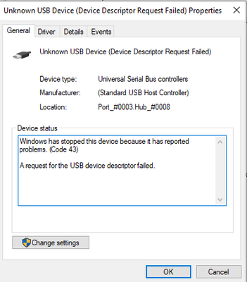

Hi, I want to get log using Type-c, and using freertos to run all the tasks.
setting:
MCU STM32L4A6VG
STM32CubeIDE 1.12.0
STM32CubeMX 6.8.0
tera term 4.106
when i insert Type-c, device manager return the unknown usb.

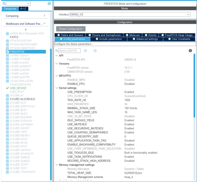

I try some methods:
1. put MX_USB_DEVICE_Init() before MX_FREERTOS_Init() -->unknown usb error 43
2. put MX_USB_DEVICE_Init() in task -->unknown usb error 43

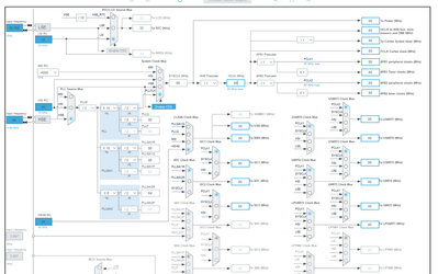

3. increase MINIMAL_STACK_SIZE to 1024 -->unknown usb error 43 (ref: https://community.st.com/t5/stm32cubemx-mcus/nucleo-h723zg-usb-cdc-communication-not-working-when-using/m-p/662907 )
4. change clock output -->unknown usb error 43(ref: https://community.st.com/t5/stm32cubemx-mcus/unknown-usb-device-on-stm32f429zi-device/m-p/75508 )
5. i dont think i need interrupt in usb, but this ref make me confused (ref:https://community.st.com/t5/stm32-mcus-embedded-software/stm32g0b1-usb-device-not-recognized-in-windows-10/m-p/135939 )
It will be very helpful if any one tell me something. Thank you.

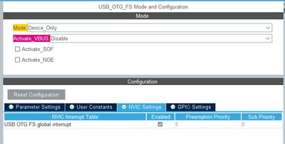

Can you include your code?
You definitely need USB interrupts enabled.
2024-08-14 8:13 AM

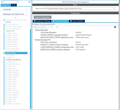

Hi @alyssa
Based on these attachments, there might be missing or incorrect device descriptors in your configuration. You need to check them.
2024-08-15 2:50 AM
thank you for you reply.
If you say the interrupt in NVIC settings. I have set it before (sorry make you confused), but still get unknown usb error 43.
