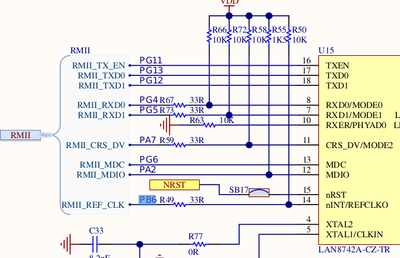

The MX_ETH_Init code is generated with STM32CubeMX 6.14.0, the pin assignment is according to the schematics:
https://www.st.com/resource/en/schematic_pack/mb1737-h7s3l8-b02-schematic.pdf

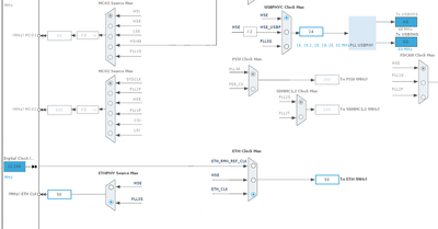

@FBL wrote:Ensure that the clock configurations for both peripherals are correctly set and do not conflict.
The clock configuration has been set as shown:
It shouldn't be any conflict. Right?

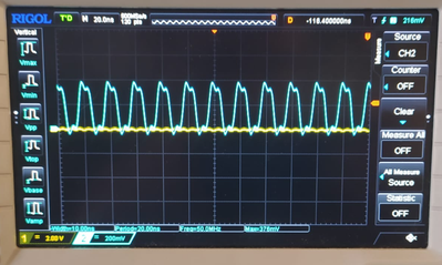

I also checked with oscilloscope the ETH CLK on PB6 (also available on CN12 of the board):
50 MHz, max 376 mV as show below:

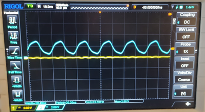

This is with 10x probe:
Anyway, the execution of MX_ETH_Init() fails in HAL_ETH_Init checking for SWR reset bit in ETH_DMARR register. In other words the bit is not automatically cleared.
