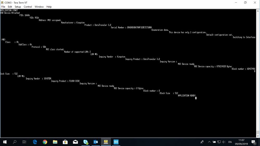

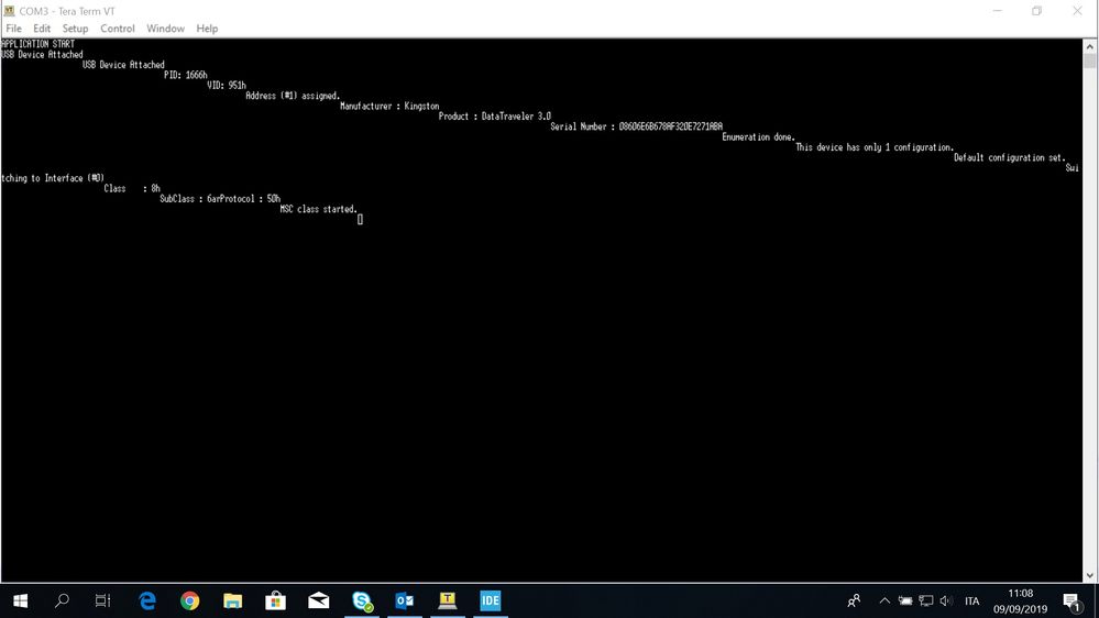

Defining USBH_DEBUG_LEVEL 1U i obatined the following debug prints:
1) Working case without CMSIS
2)Not working case with CMSIS
