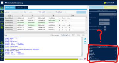

2023-10-27 1:08 AM
i don't resolve my problem :(
I think the problem is : i doesn't have CPU information loaded in dfu mod (see picture )
2023-10-27 7:59 AM
What's the problem? Looks like DFU is running fine.
