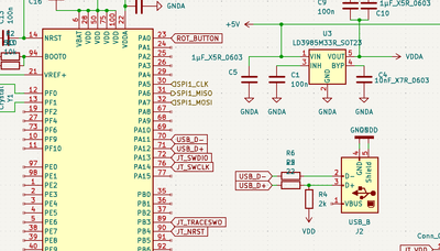

It seems the USB interface might be damaged, but I don't understand why. Here’s how I’ve wired the interface. In this schematic, VDD refers to the 3.3V that powers the STM32 itself.
I’m unable to pinpoint the issue or make a diagnosis about what happened. Please note that I did not connect the ground of the XP power supply to the PCB ground (my box is made of plastic, so grounding isn't required), and I believe this is also the case for the GW Instek power supply. But even if both were connected I would not really understand the problem.
Do you think the internal USB hardware of the STM32 chip is likely damaged? Does anyone have an idea of what might have caused this issue? Should I consider adding extra protection to the USB connection on the PCB?
