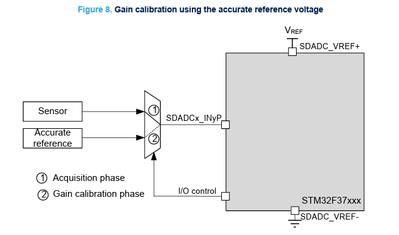

*to calibrate the gain do I have to put a stable voltage at the analog input? what value should it have? does it have to go into the same pin I use to measure 0-80V DC or another analog input?

To calibrate the gain - you can use another SDADC channel (pin) - because the gain is present in SDADC and does not depend from input channels multiplexer. This avoid to use external analog multiplexer on the same analog input (same pin - as it is on your schematic).
