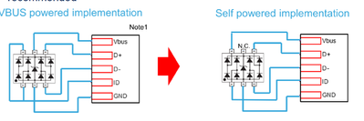

3. For Schematic, ST USB training says to connect VBUS to I/O line of USLC6-4S ESD Chip , Instead connecting it to its VBUS pin.
