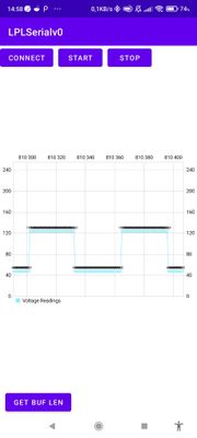

}The device receiving the USB serial communication is an Andoid Phone. Here is the graph it plots, sampling a signal (this part of the signal is the preamble) with bit pulse width of 400us:
I'm very pleased with these results, as I was starting to think an Arduino Uno was faster at serial communication than a STM32F042F6P6.
The resulting baud rate is: 8*(1/12.5us)=640000 baud
Although I would be capable of transmitting (sampling) even faster. I was sending 256 bytes per frame. That is a limit of ~2Mbaud in theory, until the CDC_Transmit returns BUSY. And I could have pushed it further towards the 1MB/s limit of USB FS, that is util my 48MHz clock gives out. But my requirements were met, I surpassed the 26us resolution of the Arduino UNO.
