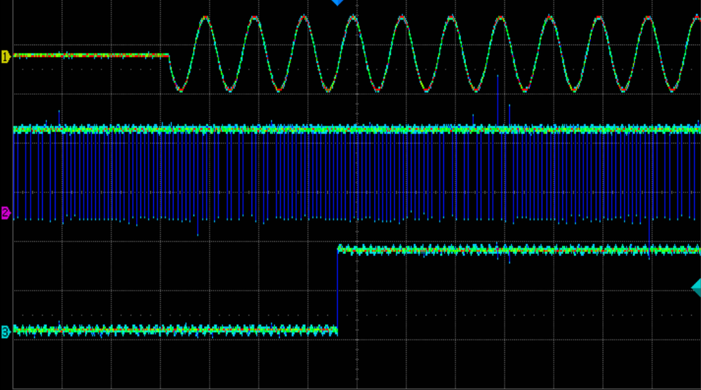

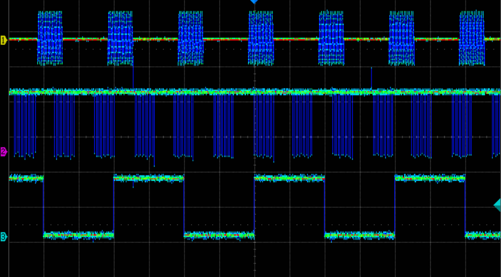

As you suggested, I have check the optputs of my code with a scope. The following figures show the obtained results:
CH1(yellow): sine wave @1KHz;
CH2(pink): FPGA's almost full flag;
CH3(blue): this signal change polarity every time the program enters in the
HAL_SAI_Transmit_DMA function;
FIG1: 20ms/div
FIG2: 1ms/div
The main problems of these results, in my opinion, are:
1) the sine wave is periodically truncated;
2) CH3 change polarity every 40ms. However,
the
HAL_SAI_Transmit_DMA function would be called by the interrupt handler every 20ms (because USB host @48KHz produce 384byte/ms and the half buffer is
7680 byte (7680/384 = 20ms)
). So it seems like thewhile (HAL_GPIO_ReadPin(GPIOB, GPIO_PIN_15) == GPIO_PIN_SET); is asserted too often such that the BSP_QSPI_Write function is not able to sent enough data in 20ms.
However, I have already tested both the FPGA side and the BSP_QSPI_Write function with the SPDIF interface, which is actually working correctly.

I don't understand CH3 should be what ?
